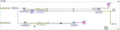

The only change I had to make was to write Frames Out Stream instead of Single Point. For some reason, the latter wrote (and then read) only 3 of the 5 frames on to the CAN bus. I verified on CANalyzer that only the 3 frames were being transmitted to the CAN bus, so the issue was with the write session and not the read session.
Here are the snippets showing that.
Session type: Frame Out Single Point
 Output (3 out of 5 frames read):
 Session type: Frame Out Stream
Output (all frames read): 
This could be a timing thing, I am not sure.
But thank you. Converting sessions to frames first and then writing those frames with echo transmit on did exactly what I was trying to do.
Appreciate everybody's help a lot!
