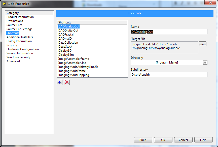

I've tried it multiple times, but realized that at one point it consumes too much memory when opening the shortcut builder menu at a finite amount of files.
When I had six executables and thus about 100 files in the Installer Dialog, it would already rise to about 1,1 GB of memory. When adding the seventh executable and then creating the seventh shortcut, it would rise to more than 3 GB and LV would crash.
I eventually solved it by manually modifying the .lvproj file with Notepad, copy/pasting the shortcut properties and then build everything. This worked out for me, but is far from practical.
Do notice below that the list of shortcut is not complete, in this installer it should install about twenty executables and shortcuts. So there is something fishy about that Shortcuts tab ....
