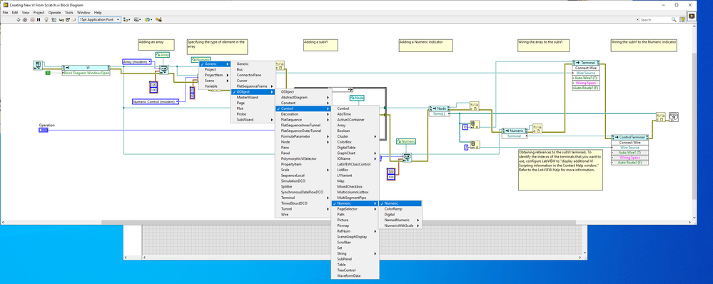

I have looked at scripting as you suggested and found some examples that could be useful. More specific I have looked at "Creating New VI From Scratch.vi". I have never looked at scripting before but it looks pretty cool.
But I am not sure about how I can change the numeric representation of the control

If you have a numeric, the property should be there.
If it's not a numeric, you need to replace it with a numeric first.
A good rule with scripting is to settle for automating 95% of what you want. The other 5% will often take so much time, it's faster to all of it manually. Of course some tools need to work 100%.
Also, use as much premade code (including controls) as possible. It will be much easier to move a (duplicate of a) numeric into a cluster, than to change a string inside a cluster to a numeric. So, cheat...
If you tell us exactly what you want and how you want it, you can give you hints (even code) to get there.
