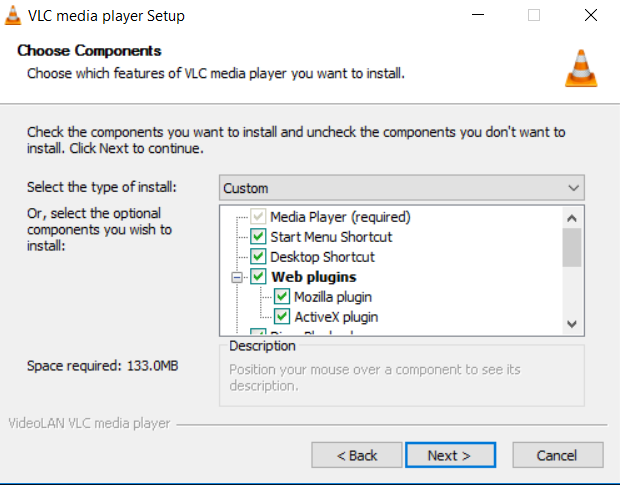

Hello TUDarmstadt LLX,
you have to install the corresponding plugin during the installation of the VLC Player:
Afterwards you can use the ActiveX Container or the ActiveX Automation Open to create a reference you can use:

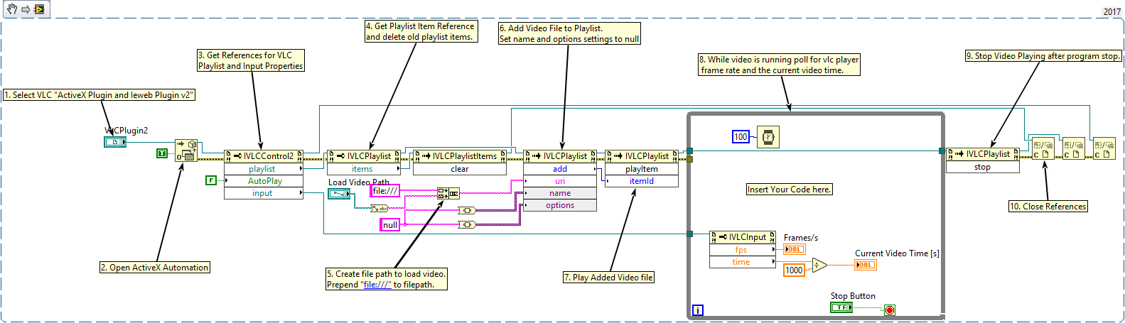

Since i recently created an example code snippet i have attached this too:

Hi Fabian,
I have done as what you write, but I still can not find the object for the VLC media player.

Accepted by TUDarmstadtLLX
most likely you are using Lv 32 Bit and installed VLC 64bit, which in this case is not compatible.
Try to install the 32 bit version of vlc.

Hi Fwehne,
I duplicated the code you have shown to us. However, nothing happens. I wonder will you be able to tell the reason why?
I also tried with Windows Media Player, which works.
I have gone through some of the examples in this link:https://forums.ni.com/t5/Example-Program-Drafts/VLC-scripting-in-LabVIEW/ta-p/3515450?profile.langua...
I am not sure what they want to achieve, but the tool seems to be the dynamic link library rather than ActiveX.
I wonder if VLC ActiveX is functional or not in LabVIEW.
