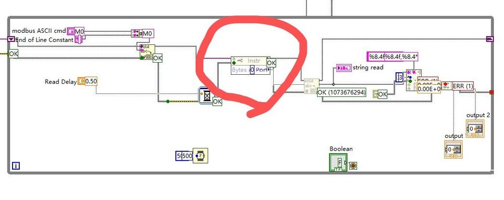

However, when I connected the control unit with NI myRIO, my VI stop working. The device showed up in NI MAX under myRIO. But after sending the "M0" command, the VISA resource has ZERO bytes on the port, meaning I didn't get any data (see the highlighted execution).
When connected to myRIO, I got zero byte of dataWhen connected to myRIO, I got zero byte of data

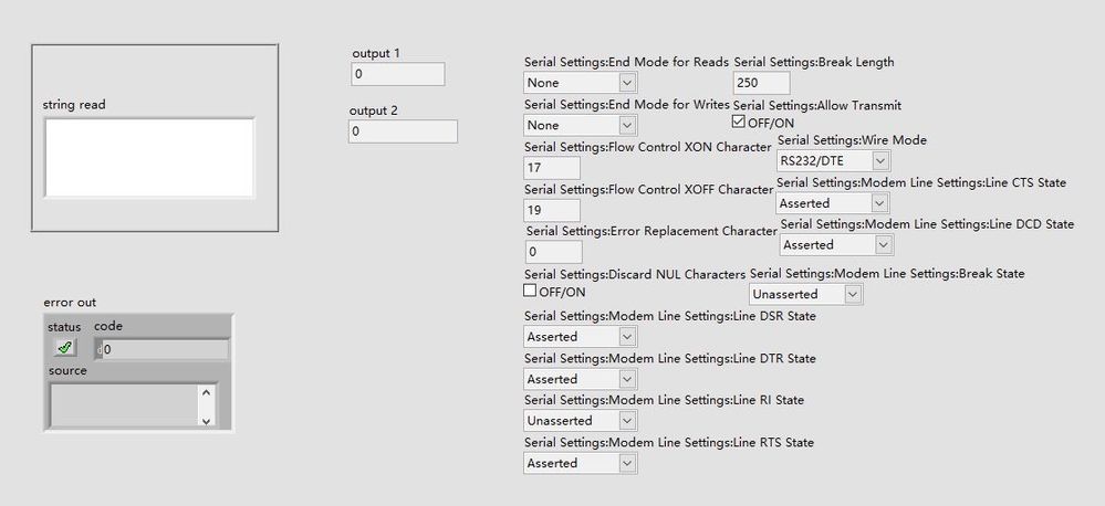

I thought that the I/O settings of the myRIO port might be wrong. Then I showed all the serial settings of both the PC COM port and the myRIO port (seen below). There were three differences between them: Line CTS State, Line DCD State, and Line DSR State. But I couldn't change these settings using the property node because they're read-only.
serial settings of PC COM portserial settings of PC COM port
 Serial settings of myRIO portSerial settings of myRIO port

CTS and DSR come from the device so that is why they are read-only.
No idea what the laser controller wants, but keep in mind that the EOL constant is different on your PC (\r\n) than it is on the myRIO (\n).

I finally got it working!
Because my project needs several USB devices connected to myRIO, I was using a USB extender. When I removed the extender and connected the RS232-USB converter directly to myRIO, I could get my data! Then I plug the extender back and connected the converter to the extender. My VI was still working ok!
I don't know why.
