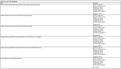

I'm still trying to get this to work, here's some updates I've found:
1. I realized I never showed the 3580 info dump, so here it is. Not entirely sure what it's supposed to look like so can't really say whether or not it's wrong or not
2. I was thinking maybe it had something to do with the Web Configurations, but after trying to open it, I remembered why I'd never used it before, because I didn't have silverlight.  Do you think there's something in there that enables the server?
3. Are there any startup settings I need to have enabled/disabled?  I tried enabling all of them (other than force safe mode) and still nothing, but maybe one of them is blocking it?
4. When looking at DSM, the variables I'm trying to read are under My Systems.  Should I be trying to get them from the Network Items?
5. I tried to take a step back and deploy the variable on my local machine, and after confirming that it works in LabVIEW, I tried to use the URI in the browser again.  Using the URI http://localhost:3580/nivariable/VariableValues('ni.var.psp://localhost/Variables/TestVariable')?$fo...
I got a different response than last time, this time stating 404, Cannot open document for:
Message 10 of 12
