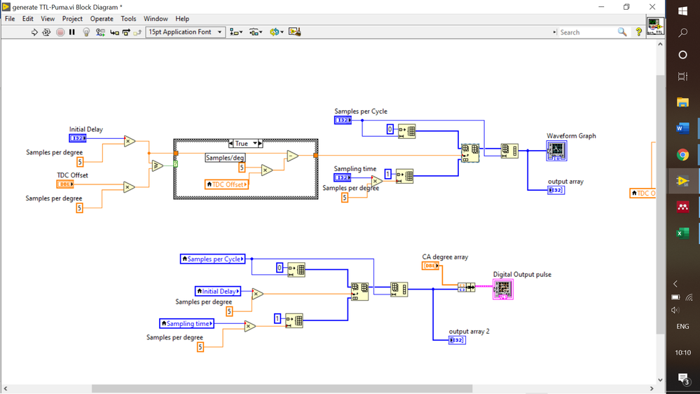

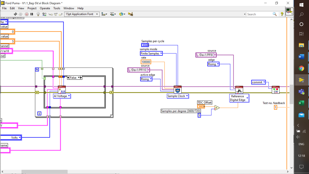

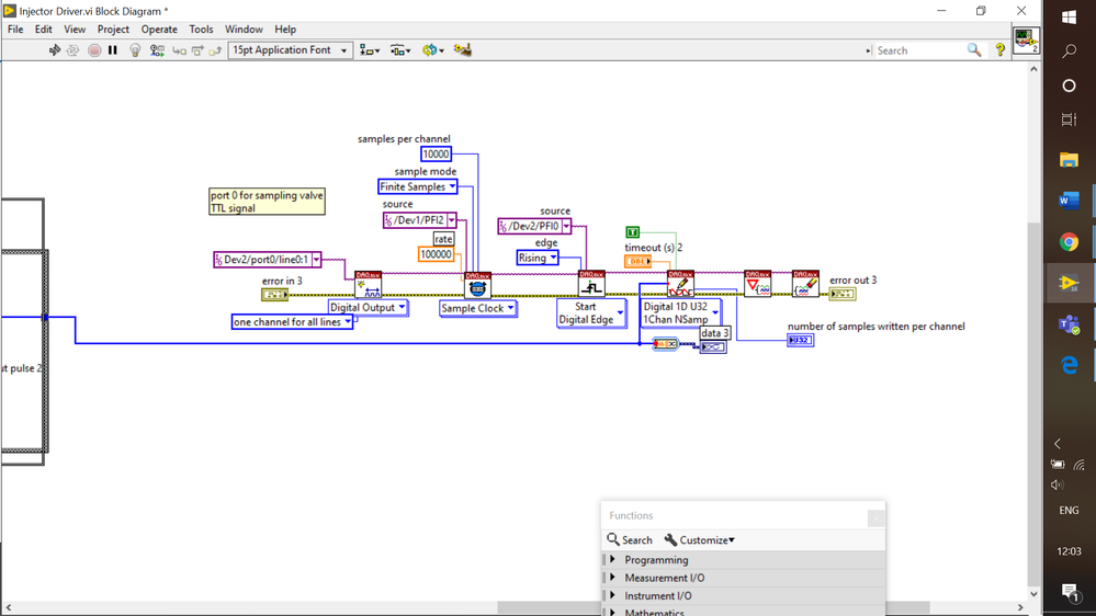

I've attached the pictures for the other previous setup which uses the CAD array as both the timing and duration of the pulse signals. As I said, I had hoped to be able to (relatively easily) create a time controlled pulse depending on whether the sample number had reached beyond a certain sample number, and maintain this existing setup for the timing of the pulse.

I've attached the relevant snapshots of the current set-up which may help.

Injector driver 1.pngInjector driver 1.pnginjector driver 2.pnginjector driver 2.pngTTL output.pngTTL output.png

Not on this PC, but on another, we measure the speed of the engine with an analogue input and the Z index (I assume) that you refer to is offset because the shaft encoder picks up TDC just before 360 degrees (the actual TDC). Would this mean on the code that the start digital edges could be replaced with "reference digital edges"?
I have attached some code from the other PC to illustrate the input that I'd be using.
How exactly would you control the timing of this? As I'd said, I'd envisioned a case structure that sets this to go off once a certain sample number had been reached i.e. the injection/spark would go off a few degrees (or ticks in this case?) before or after the real TDC.
