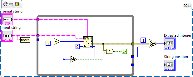

Altenbach -- reversing the directory listing isn't simple... that *requires* that the directory listing come back in numerical order OR that we are able to extract the integer out of the file names and then sort those -- both of which we've mentioned as difficulties earlier in this thread. Any proposal on how to make the Scan From String find the last string that matches the given format string? Because I sure don't know how to do that.

@JÞB wrote:
Scan them all, take max, store in a secure location that no one else can get to linked to this filename to match.
I don't know how to scan them is the problem. Suppose that we just use the default " (%01d)".
 How do you find the last instance of a scan code in a string? You could have a string like
    (7  (6)  (5).txt
Here's the only way I came up with to do it:
Message 29 of 48
(2,950 Views)
