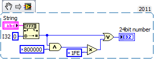

i get a 24 bit 2's complement hex number in string format from serial port. i want use this hex number in continue in my LabVIEW code. but it doesn't work correctly !!
in example if i receive ffffff it is equal to -1 and if i receive 000001 it is equal to +1 .

As JB's link doesn't work for me (right now as NI website seems to have its problems) I attach this snippet:

Thank you friends.
but finally i want a number that can be positive or negative. in fact i need number in DBL format with it's sign.

Hi ajapyy,
an I32 is sufficient here as it also keeps the sign (and your "hex number" doesn't come with fractional digits).
You are free to convert the I32 to DBL later on…

That's a pretty clever sign extension, but a little difficult for me to wrap my brain around. An alternative to let LV do it for you would be to use a 24-bit fixed-point type for the conversion:

Hi JLewis,
get the sign bit, multiply it by 2*255 to fill the upper 8 bits of the I32, OR it with the remaining bits of the number…
