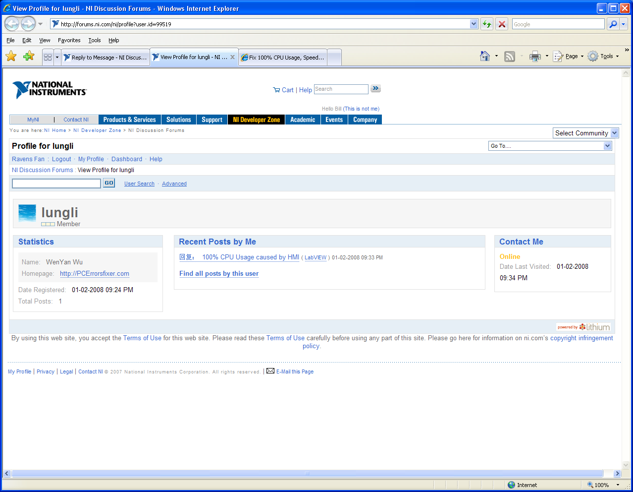

This looks an awful lot like spam!Smiley Mad
Besides the bad English which doesn't give any confidence that this is professional software,  lungli had just created an NI account today and advertises a homepage that seems like it is affiliated with the solicitation.
Message Edited by Ravens Fan on 01-02-2008 09:56 PM
