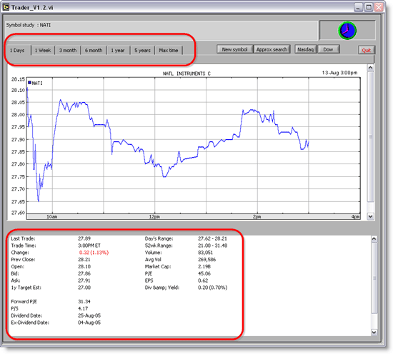

Usability - Adrien's VI provided easy access to all of the data. Notice how all charts (for specific timeframes) were accessible from a simple tab control. All statistical data was listed using a multicolumn listbox which was always viewable, regardless of which chart you are viewing. This made it easy to see all sets of data simultaneously.

Speed - This submission ran very quickly. Once a new stock symbol was entered, it took approximately 2 seconds to download and plot all data.Relevancy - The data sets provided were all very relevant to someone investing in the stock market. Adrien's VI provided:
  • Charts at 1 day, 1 week, 3 months, 6 months, 1 year, 5 years, and the maximum time
  • Last trade price
  • Last trade time
  • Change in price for current day
  • Previous day's closing value
  • Today's opening price
  • Current Bid
  • Current Ask
  • 1 year target estimate
  • P/E
  • Forward P/E
  • P/S
  • EPS
  • Dividend Date
  • Ex-Dividend Date
  • Day's Range
  • 52 week range
  • Volume
  • Average volume
  • Market cap

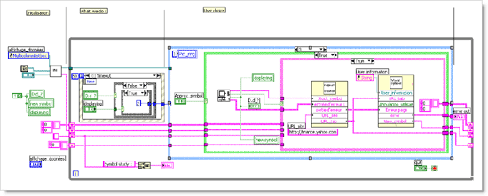

Coding Style - Adrien used excellent coding style. His code was very clean and was actually broken into sections using lines and comments. This made it easy to understand which section of code performed each part of his application.
