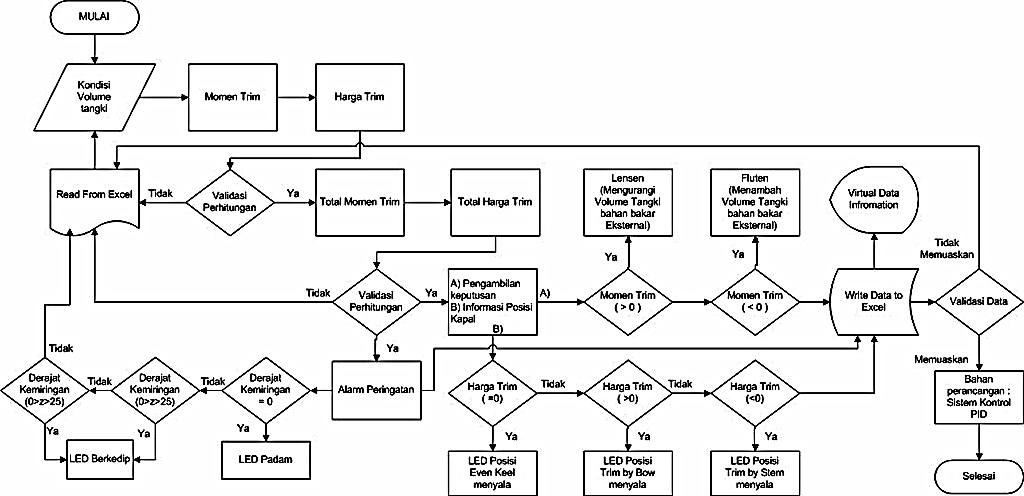

mungkin jelasnya sperti flowchart berkut mas....
