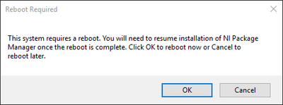

@Mads wrote:
First experience with the update so far: when you download the fresh 2024 installer the NI Package Manager that comes with it is already outdated(!). So if you are installing on a clean machine you have to abort the install at a point, restart the now just installed NI Package Manager version, update it, and then restart the initial installation. Not particularly smooth...
I can confirm that the NI Package Manager included in LV 2024 is already the latest version and will automatically install, so that's probably not the issue. Was it a dialog like the following that you saw?
If so, what's happening is that since 2023 Q2, Package Manager updates the Microsoft .NET Framework to 4.8 if the system is not already at that version. Unfortunately, that .NET update can sometimes put the system in a state that a reboot is needed before any further installation can be done. Though annoying, this is just what the Microsoft .NET update requires. But the majority of systems have this version (or newer) of .NET already, the reboot is only necessary sometimes, and it's a one-time update - so it's not seen frequently. Do reply back if you saw something different!
Message 6 of 27
(6,960 Views)
No this was a dialog from a volume license installer I created from the 2024 Q1 Embedded and control suite offline package that said that with the options I had chosen to install the process had to be aborted due to the need for an update of the NI Package Manager (prior to this the machine had no NI software at all). I aborted and opened the Package Manager which then showed the usual link in the upper left corner saying an update was available. Having run that update I could proceed with the VLM install.
Gotcha! Yes, this is an issue with VLM, that the version of NIPM installed on your VLM machine is what is used to create the VL installer (VLI). This works fine, except if the product you are including in the VLI is built with a newer NIPM version (like LV 2024), then you see this mismatch error.
The workaround is to first update NIPM to the latest version on the machine building the VLI, then all VLIs created on that machine will be using the latest NIPM - which will avoid the problem. We hope to improve this experience in the future by warning you at VLI build time of this mismatch so that you can be aware of the situation before rolling it out.
Sorry you ran into this issue!
