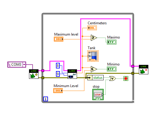

I would consider myself considerably knowledgable regarding LabVIEW and I wouldn't even attempt writing code with the basic VISA functions for this application.  It will be much easier to use LINX.  If you look at the example program offered to you when you upload the firmware via the Firmware Wizard, it is half of what you need.  The only other thing you need is to read a digital pin.
I modified the example from LINX to do what your code does.  See attached.

Greetings, I have very little experience using LabView, I am trying to develop the filling and emptying of a tank. A mini pump will fill a tank to a certain level and an electrovalve will empty it if it exceeds the level, I just do not know how to add these components. If someone can help me, I'm grateful
