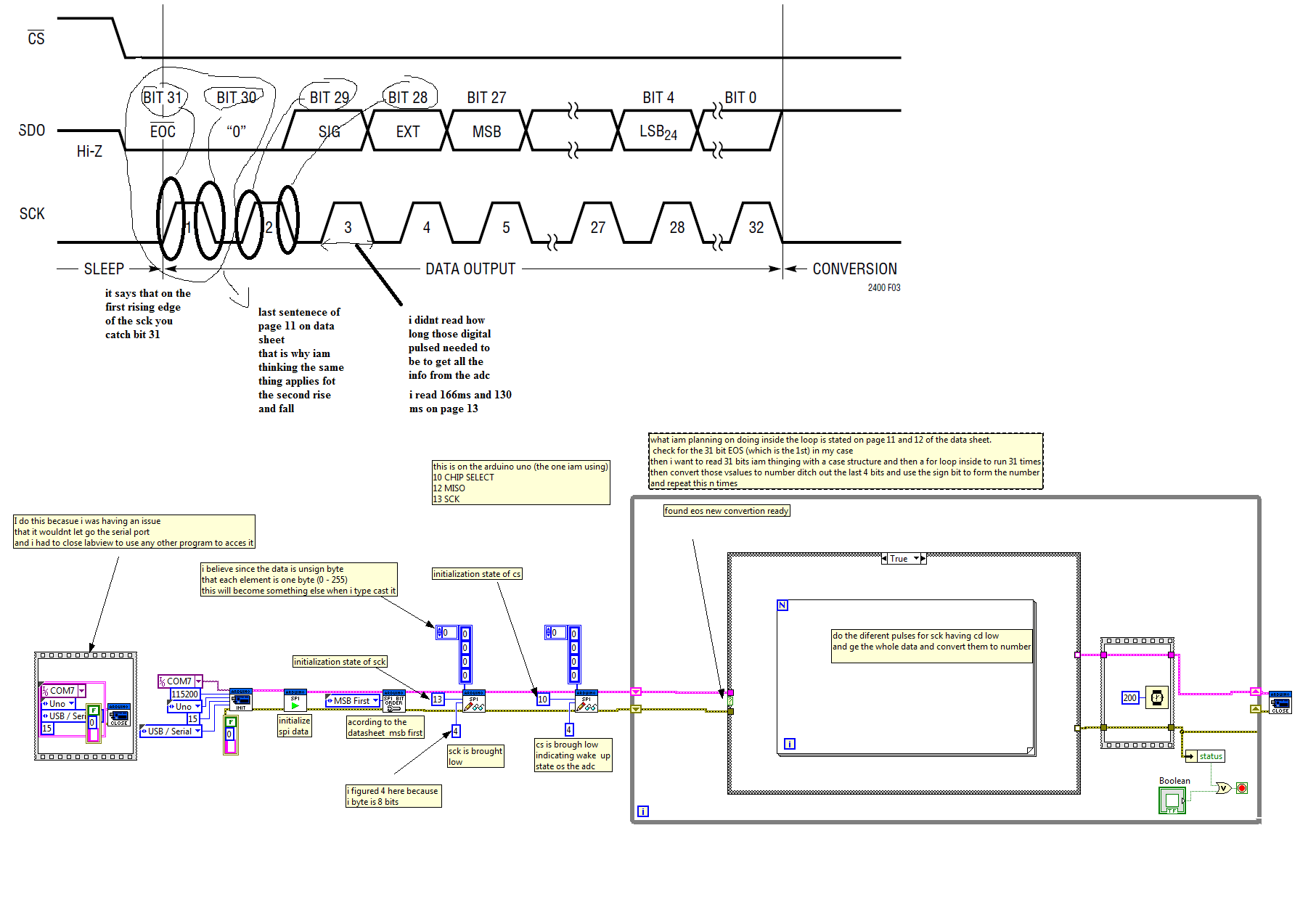

i also post a .jpeg with the code i have as well as figure 3 on the data sheet with my thoughts and questions.
iam sure many of them are trivial but this is my first time trying sdomething like this.
i will also post the datasheet of the adc.
it will not let me upload any thing else other than images. no vis nor pdfs

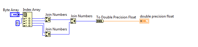

I am reading what I believe is the voltage of interest, but in order to be sure I need to convert the 4 bytes (type unsign byte U8) to something mininfull to me, such as (DBL). until now i have not been successfull in doing so, and Iam uploading a .jpeg file to show you.

caluctra,
Instead of type casting the bytes as longs you will need to join then first, then type cast them to double.
First decide if the bytes are sent back most significant byte (MSB) first or least siginificant byte first (LSB).  Once you know the order you can use the Join Numbers primitive to take two 8-bit numbers and join them into a single 16 bit number (order matters!!!).  You can cascade the join jumbers VI to join all 4 bytes into a single 32 bit number, then change its representation to double.
Assuming MSB First:
Let us know if you have more questions.  You are getting close!
-Sam K
LIFA Developer
Message 6 of 19

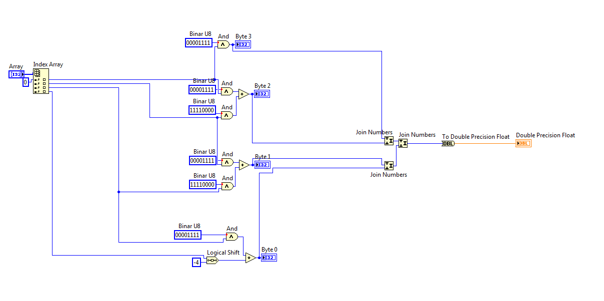

Alright lets try this again.  My original post was nonsense.  This is a bit more complicated and I really don't like the format that this sensor returns data in.  It involves a bit more bit shifting, but isn't too bad.  I've attached the code this time as well.
Let us know if this helps.
-Sam K
LIFA Developer

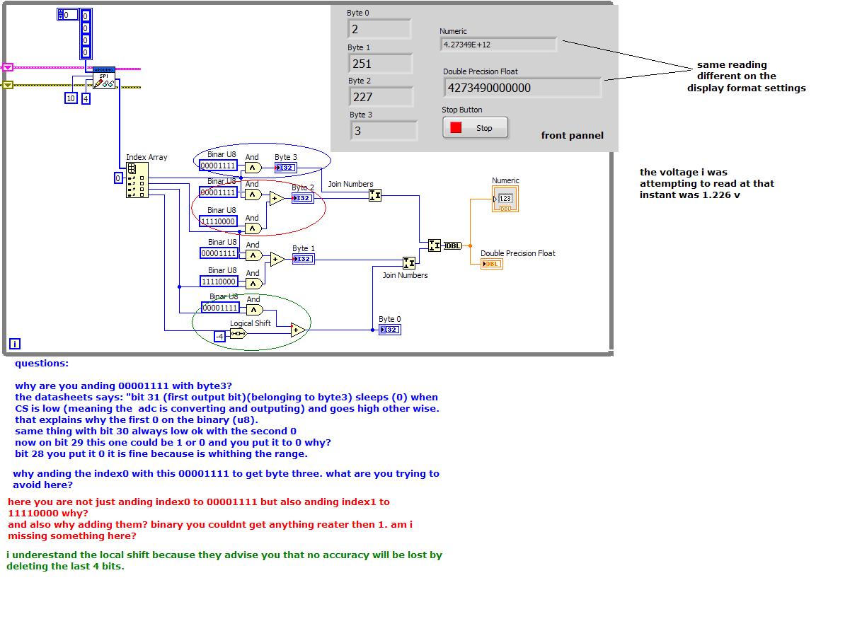

Sam,
Iam still unsuccesfull in reading the value although the readings cut by half. there is no decimal point on the reading, and keeps being a huge number compare with the actual value.
