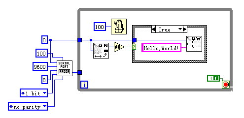

EK-LM3S8962:Serial Port Write.vi is Not activated?
The following VI running in the PC-side have not received "Hello, World!" Character?
24300i0DA30D7DB4EF5113
(6,649 Views)
But as long as the serial port from a PC, transfer any character to EK_LM3S8962 board, so that you can receive the "Hello, World!" Strings.

Sorry, this VI program can send the RS232 port data. Should be a RS232-USB driver did not install completely, or PC, RS232 transceiver VI caused.
