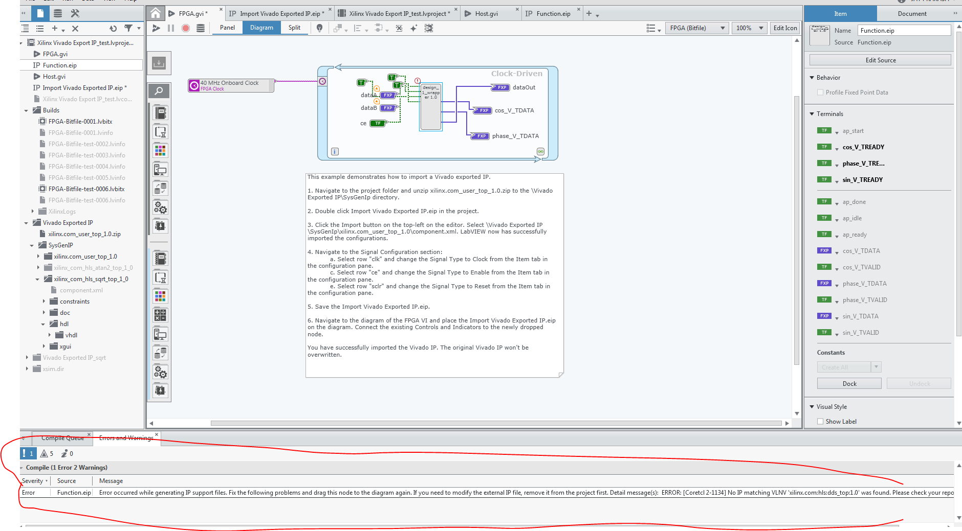

Hi!
As update I did use Vivado as you said. Previous works used IP from VIVADO HLS.
Now I used IP catalog of Vivado Hls in Vivado and then generated IP.
The good news is ports are identified now.
But when I use the IP in Comm Suite to give input and fetch output it fails to get xilinx:hls: (top module of the project)
Actually using this method(attached pdf for steps followed) design_1_wraper.vhd is taken as top module rather the actual file generated by the vivado hls like for dds example it should find xilinx:hls:dds_top.
Whats cause of this error?
The error snapshot is attached.
Message 7 of 11
(7,123 Views)
What I conclude till debugging now is that generating IP from VIVADO helps identify the HDL port correctly and there is no error in .eip file as previously.  But when running FPGA it compile FPGA and returns error:
Error occurred while generating IP support files.
ERROR: [Coretcl 2-1134] No IP matching VLNV 'xilinx:com:hls:sqrt_top:1.0' was found.
The IP file is attached.
Message 8 of 11
