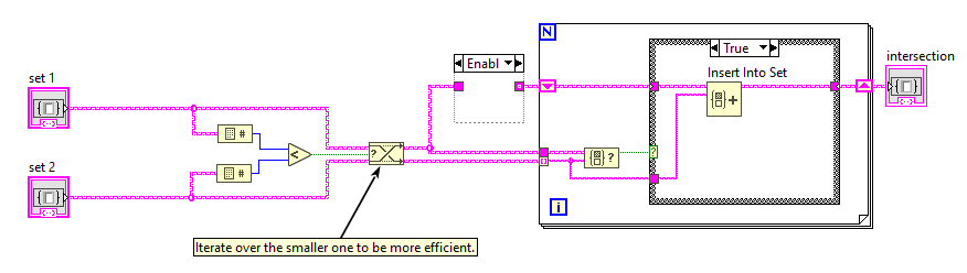

I found something curious when using Sets to solve one of the problems this time. I happened to look into Set Intersection.vim:
There's a Diagram Disable structure hiding in, where the default output (an empty Set) is feeding the shift register, rather than a constant empty set. The Disable case shows y' output of Swap Values wired into the SR. A bit of debug code left over? Something that's edited in the VIM for another case? A constant abducted by aliens?

It's a VIM, e.g. it's logic works independent of the input type of set that it's given. That set could contain a string, a number, an array, a cluster, any type at all, and the loop needs to insert those values into a new set.
That diagram disable is using type propagation to give an empty set of the same type as whatever ends up being connected to the input 🙂

A smart way of adapting - thanks for the explanation 🙂
