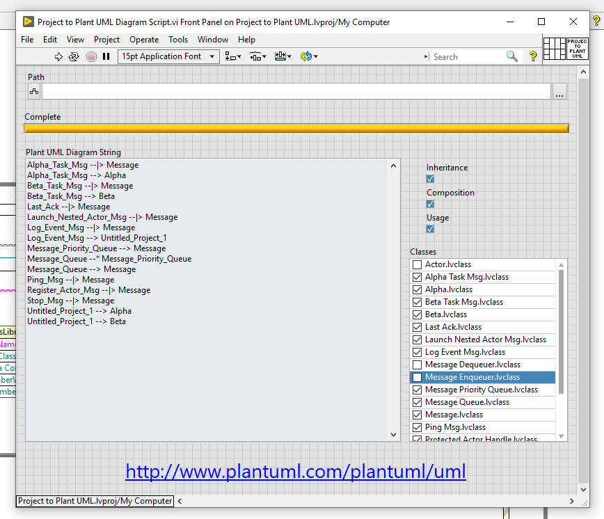

I needed to visualize my object oriented design. The Class Hierarchy in LabVIEW only shows inheritance relationship. I wrote a simple VI scripting tool which would show also usage and composition. It produces Plant UML string representation which can be used in an online tool http://www.plantuml.com/plantuml/uml to convert to a diagram. The created Plant UML representation can be a starting point for your documentation, you can edit the string to provide more info or use as is.
It is using LV19 because I needed sets and maps for class relationship representation. Cannot save to previous version, sorry.
Project to Plant UML DIagram ScriptProject to Plant UML DIagram Script
Plant UML online tool with examplePlant UML online tool with example
Scripting through a project to extract all class relationships into a mapScripting through a project to extract all class relationships into a map
Capturing inheritance relationshipCapturing inheritance relationship
Capturing composition relationshipCapturing composition relationship
Capturing usage relationshipCapturing usage relationship
I hope this helps. Enjoy!

I did similar things for a few tools (GraphML and Modelio), but never really to my satisfaction. I have ~300 classes in ~90 hierarchies, and some of these tools don't really scale up very well. Often, ordering needs to be done manually, and each and every time.
Can you post a PlantUML file (of some significant projected preferably)? Just so I can test the PlanUML features, and get a feeling?
EDIT: I can of course try myself as you posted the source code...
EDIT2: Except it's in LV2019...

Sorry it has to be LV19 because I use sets and maps inside.
For big designs it is absolutely critical to only show the classes and relationships you are actually interested in. By default everything is shown but this results in the following...

The resulting diagram is so big that Plant UML cannot handle it as one PNGThe resulting diagram is so big that Plant UML cannot handle it as one PNG
That's one of the things I am struggling with. I almost made a comment on that in my first post, but didn't want to make things complex straight away.
What would be perfect is to have 'views' of some sort that do adapt to changes, but somehow limit the diagrams that are made. I did get that working, by simply blacklisting\whitelisting names (reg.ex. of course), but it's all done by programming. Going from a concept with VIs to a useable GUI is a big, big step...
I've found that what you want as a diagram can be completely different depending on how (and by who) it's going to be used.
The difficulty isn't really in the programming. It's about the requirements. I'm still figuring this out. I use mostly ad hoc diagrams now, but it's a lot of manual labor.
It would be perfect if what you made could be fed into an existing tool, and if the tool had views\rules to make the appropriate diagrams. Just so we don't have to make it.
Ah, well, we see how far we can take it Smiley Very Happy.

I love this idea with managed visual representations, where you just save the rules how you want to create them e.g. which relationships and which classes. Give those rules each a name and you can easily switch between diagrams.

Here is a LabView 2020 update that includes methods and interfaces. The code could need some more cleanup but it works fine as far as I can tell. Classes now can use spaces in their title.
There is also a separation between inheritance and interface implementation (..|>) now.
I've also written a primitive import plugin for StarUML (v5.1) to import plantUML, which is useful for large project since you can select what to view and move the elements around.
All credits go to the original authors.

Thanks Chris for the update for LV2020!
I tried running the script you uploaded and it is missing "SetIsInterface.vi"
Message 7 of 9
(3,521 Views)
Sorry for the inconvenience. I've attached the file, please let me know if anything else is missing.

I recently looked into Mermaid.
The main reason was that GitLab automatically turns Mermaid text in documentation into diagrams...
The markup is quite different compared to PlantUML, but if the datamining is split well enough from the output generation, it should not be too hard to output to any format out there (PlantUML, Mermaid, XMI, GraphML, StarUML, ...).
I'm still open to suggestions\experiences about how to limit the diagrams. Showing 400 classes in 80 hierarchies in one diagram is useless.
BTW: Mermaid markup is very simple, but it doesn't seem to be designed for names with spaces, '(', ')' and '.' in the class, property and method names... I don't recall if I got all that working in the end.
