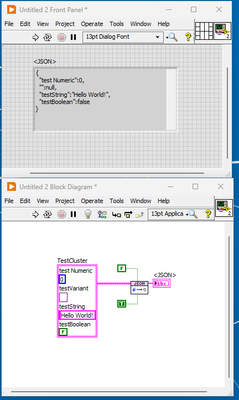

I discovered this bug with unnamed variant if it is a void variant (empty as null) using fiunction 'To JSON text.vim':
AS you can see in the output, the "testVariant" name is not displayed in the JSON data output!
Discovered using v1.8.2.122 and 1.8.1.121
BR,
