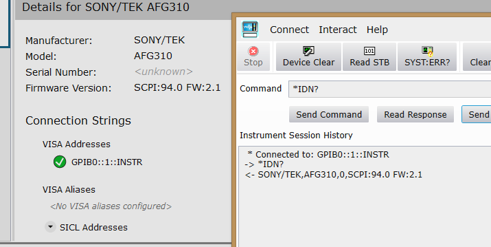

Hi all, I have an Agilent 82357B GPIB/USB interface and I'm trying to use it to communicate with a Tektronix AFG310 Function Generator (FG). I've used another Agilent 82357A in the past (like, earlier today) with this PC and that works perfectly, so I assume all the Agilent/VISA stuff is still working.
It shows up in NI MAX as GPIB0::1::INSTR. This is the first strange thing, because when I set the GPIB address to be 5 in the FG's menu, it didn't show up in NI MAX; it only works if I set it to 1... but I thought the machine dictates the GPIB address and NI MAX displays that?
Anyway, so when the GPIB address is set to 1 in the FG's menu, I can click open the VISA Test Panel for GPIB0::1::INSTR and communicate with it, like get the system info by sending *IDN?:
I can also successfully change some parameters (you'll have to trust me that it's outputting the right stuff):
I can also communicate with it in the Keysight Connection Expert software:

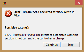

However, for some reason, when I try making a very simple VI to do the same thing, I get an error. Here's the VI I used:
With the VISA resource name:
And it's giving me this fun error:
What's going on here? I googled that error, but didn't find anything that really helped me resolve it.
It's very strange to me that I can communicate with the machine (which should be like 90% of the hard part) but my VI can't. In the Agilent VISA User's Guide, here: http://cp.literature.agilent.com/litweb/pdf/E2090-90040.pdf
It gives that error as "VI_ERROR_NCIC". It seems like there's a VISA command it gives so you can put the controller in charge, viGpibPassControl on page 204 of that link: "Tell the GPIB device at the specified address to become controller in charge (CIC)."
...but I don't really know how to use that. Does anyone know what I can do? Thank you!

Actually, what's strange is that now I can kind of get the instrument address to show up when it changes. Here's what I did. I changed the GPIB address on the machine to 3, then refreshed MAX. It doesn't show up there, and the old addresses (none of which are still plugged in, by the way) are still there. Then I go to the Keysight Connection Expert and 'Rescan', at which point it shows up in the list of my instruments (of which the others are the same machine, but with the past GPIB addresses I tried, similarly to in MAX...). After this, if I refresh MAX, the new address GPIB0::3::INSTR shows up in the list, and I can communicate with it using the VISA test panel.

Alright, sooooooo now it's working.
I can't say for sure what happened, but I did click the "check for updates" thing in MAX and then install a "critical update" 488.2 driver, and then restart. When I restarted and went into MAX and turned my machine on and refreshed MAX, that huge list of devices was gone, and the new address is there. I could communicate with it in the VISA test panel so I tried it with my program and now it magically works!
