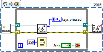

The "Acquire Input Data.vi" does not recognize the keyboard layout correctly.
The "Acquire Input Data.vi" recognizes the keyboard layout as an English layout, although the layout is actually German.

- The "Acquire Input Data.vi" automatically recognizes the currently active keyboard layout. (under Windows any keyboard layout can be selected).

You can review the code in the Acquire Input Data VI. You will find that a DLL call returns a key state. As i understand the documentation in the VI, the state represents all keys being pressed (array). Each key pressed is represented as numeric value, i assume that this is essentially the key ID.
You can create a localized version of the Acquire Input Data VI by adopting (copy the VI for this!) the enum. Change the appropriate symbols like umlauts where applicable.

@zoom_007 wrote:
Did I understand correctly that "Acquire Input Data VI" only knows the English keyboard layout by default?
I'm not sure if it is indeed the complete english keyboard layout... the DLL returns a numeric value of the key being pressed. That number is converted to an enum which is defining symbols for the english keyboard layout. However, it is possible that some key IDs are not included as today you can have extended keyboards and such.
What i point out is that you can adopt the enum to any language, but again: if you do this, do it on a copy other than the original VI.

I created localized Acquire Input Data VI for the German keyboard layout and created a small VI to test the German keyboard layout.
Unfortunately I noticed that there are different keyboard layouts for English, German and other languages. So it won't be wrong if other people can try the German Acquire Input Data VI with their own keyboard.
