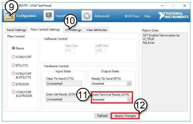

I thought you may try to connect the Pin4 to Pin4. And assert the DTR pin by the step 11 in the programming manual.
Message 6 of 10
(6,911 Views)
Do you mean this? :
step 11step 11
I had already tried it, pin 4 to pin 4, with that configuration but the output wasnt near to 12 V.
Message 7 of 10
(6,905 Views)
