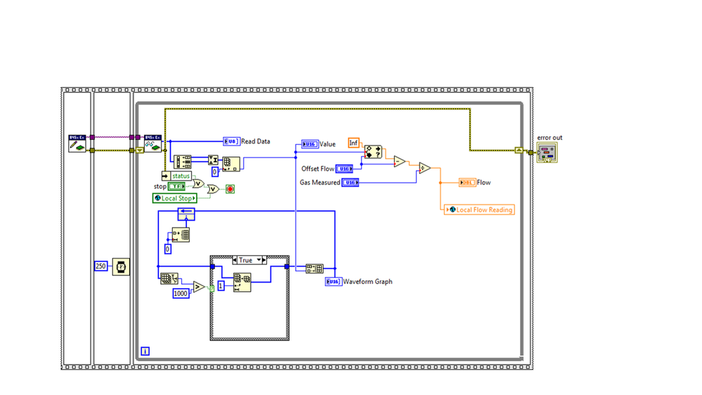

Because I've seen several threads over the course of my search, here is a LLB for my Sensirion SFM-3000 solution.  It uses a NI USB-8451 to communicate with the SFM-3000 rather than the Sensirion EK-F3x cable.  I stole copied from the 8451 examples and worked from there.
I have the data running to a Global so that the routine can simply loop but still provide the data to outside VIs.  There's probably a better way to do it, but this works for what I'm doing (so far).
