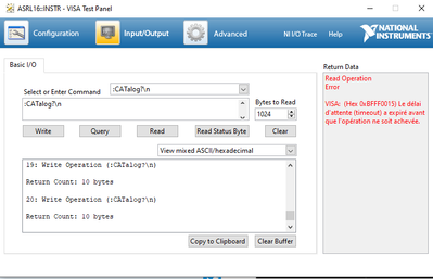

SCPI specific command does not work with VISA with MTX3293
I tried to communicate with VISA, for common commands it works with "*IDN?\n", but when I want to execute a specific command, it gives me an error "VISA: (Hex 0xBFFF0015) The timeout ' wait (timeout) expired before the operation was completed."
I am a beginner with the instrument control part on labview, someone can help me I will be gratefu
i need to communicate with VISA with MTX3293 multimetr , when i run the VISA test pannel with a commun command like "*IDN?\n", it works
 but when want to execut the specific command  to acquire the continus data from my MTX3293 it gives an error
VISA: (Hex 0xBFFF0015) the time out expired before the operation was not completed
im a  beginner with instrument control on LabVIEW , some one help me please

You are sending an invalid command.  SCPI is based on a command hierarchy and you need to go through the hierarchy.  So your command should be ":DATA:CAT?".

I did build an isntrument driver via the template. But a lot of the vi's are not yet correct for your instrument,
Because you did try to read out the catalog I did build that example but a lot more vi's have been added from the template.
So only run the "Metrix 329x Read Catalog example.vi" in the examples folder.
That should be working.
If you select the correct baudrate (the same as in the settings of your instrument)
So do not use another vi. If this works we can discuss the next step.
A lot of the other vi's are still to be modified for your instrument but I can't find an easy way to find out which functions you need and how to modify these.

the problem is solved with  my multimeter, i did not use VISA to communicate with , i just used some blocks of code from the sub VI of the driver provided on the web site of "Metrix", but be careful , using  direct Sub  Vi only can  not work , case "voltage" sub VI show me in error, i attach a screenshot of my code and programm

I did not used the driver from Metrix because I don't trust it at all. I saw too many non LabVIEW approaches so I started to build a good VISA version from a template.
The only problem is that the manual does not really specify how to measure voltage or current otherwise I would have used these.

I  tryied your solution but unfortunately doesn't work , actually  i try to measure the voltage from the commands on the  manual  but  it is  not clair the command , suddenly  i was satisfied with  the  driver  as  it worked  with me  , a big thank for  the  support  a the whole  team
