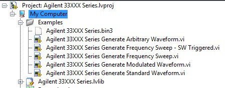

Hey Nigeltorque,
The .LLB that you are using in your application is indeed the IVI Driver for this instrument. IVI drivers can be very useful if a customer is interested in having instrument interchangability, state caching, range checking among other standard IVI features (DevZone: Using IVI Drivers in LabVIEW). However, NI's IVI drivers are IVI-C drivers which means that their source code is actually standard ANSI C. You can still easily use these IVI-C drivers in LabVIEW as we provide an API with the installer that calls into the instrument DLL but if you are unfamiliar with C then it might not be easy to modify.
If you are more comfortable with LabVIEW then I would definitely recommend the LabVIEW Plug-and-Play (Project Style) driver that Dennis is alluding to. Here's the link to the driver for your instrument:
Agilent 33XXX Series Signal Generator
If you take a look at this driver, it appears that there is already a frequency sweep example included:
Give this guy a try.
