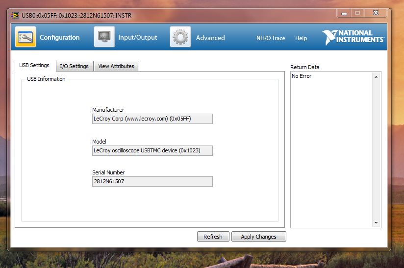

Even our VISA drivers appear unable to communicate with the LeCroy device. This could just be due to the configuration settings, if it’s not too much trouble, can you attach screenshots of each of the tabs you see in the configuration window of the VISA Test Panel? Are you sure you are using the USB488 port on the device (see page13 of the device’s Getting Started Manual), when connecting it to your computer?

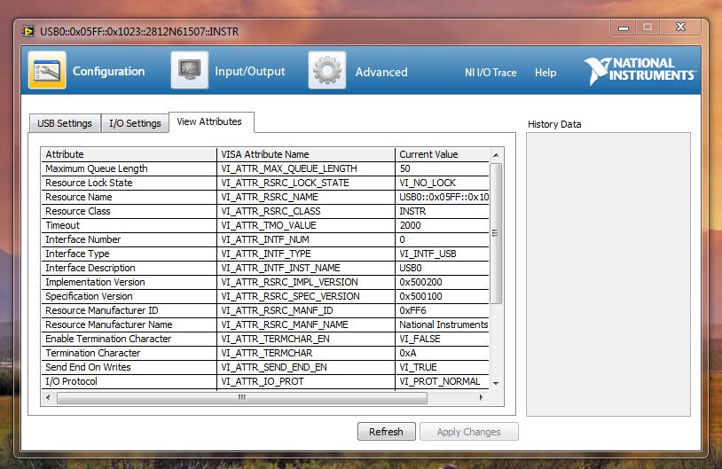

I am using the USBTMC port , so we are good there. FYI in the I/O tab, I have tried several different timeout times, none of which made a difference in the errors I am getting.  Sorry for the inline images, the computer I am using will not attach them.

Sorry to jump in so late, I have been out of the country for a while and am still catching up on things in my office.
I think you are looking for someone to say "yes, you can connect to the scope with NI-MAX and the VISA Interactive Tool, and here is how to do it"
A few things:
The LabVIEW driver for XStream scopes is the right one.  It works with all of the TeledyneLeCroy Windows based scopes.
As I see was already pointed out. (I will give Kudos soon), the scope must be setup to use the USBTMC interface.  To do this, go to the Utitlites pulldown menu on the scope and select "Utilities Setup..." on the tabs that appear at the bottom of the display, select the "Remote" tab and ensure the interface type is set to USBTMC.  This will also show you the VISA resource (I see it in the title of the VISA interactive tool image shown in a previous post).
Once this is selected, the PC should detect the USB connection and install the device. (you can see it in your device manager as a USB Test and Measurement Device:
Once this is done, you can then go into NI-MAX and it will detect and show the resource.  You can now communicate with the device:
If you have any challenges, feel free to give me a call and I am happy to walk through this over the phone.
