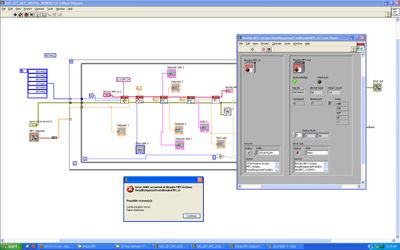

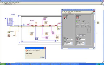

I keep randomly getting "error 5001" when I read the MFC with the Brooks vis posted here. The error stops my program and then the program continues when I push the continue button. If the error occurs again it will stop the program again. I tired the clear the error before it stops the program, but this didn't seem to help. Any suggestion would be helpful.
One screen shot of the whole vi is attached.
20555iA5D4323162A289AA
Five screen shots of the error are attached.
20557iDA1F4AE34111F9C3
20559i6D7935BCD5FF99D4
20561iDD5A3D6E24881DD3
20563i1F33C63591334185
20565iEC7E5BF4CD34159D

I would invetigate why you get a checksum error.
greetings from the Netherlands
