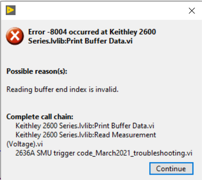

Yes, you are right.
I understand that the trigger VI is not initiating a measurement. This is why my buffer is probably empty.
To initiate the measurement I use the following measurement VIs,  "CONFIG MEASUREMENT CHARACTERISTICS" followed by "READ MEASUREMENT (Voltage)" VI.
But now, I get a different error:
It is a different error, but I think it is still because the measurement VIs are not doing what I think they are doing. Even though, in this program, I am trying to do a single point measurement and print it.
(The start and end index of the "Print Buffer" VI are 1 by default. The measurement count of the Voltage Measurement VI is 1 by default. So if this VI takes 1 measurement (as I would expect), then the print buffer should be able to print that 1 value at least without issues.
I feel like I am using the correct VI to do the measurement this time. So not sure what the issue is here.
P.S. (As soon as I run the LabView program, an error is displayed across my physical 2636A instrument; "TSP syntax Error -285 at line 1, unexpected symbol near = sign".  This error, however, does not show on the LabView panel at all. Is this error preventing the measurement from executing? )
Edited VI using measurement VIs to initiate measurement attached to this message.
