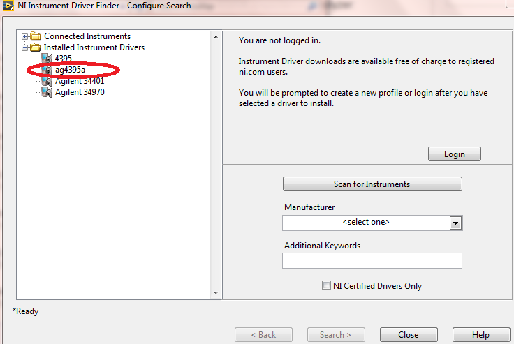

Hi Smiley Happy
Me too, I would like to buy a cable "82357B USB/GPIB" to connect my laptop to the spectrum analyser "4395A" Hewlett, I don't understand why we need to have "SCPI" to control the spectrum analyser because we can download the drive from the national instrument (see the pictures below)
after that we have the library and we can make a code to communicate with the spectrum analyser. So we don't need to know the "SCPI" command to communicate with the spectrum analyser no ?(see pictures below of the libraries and an example of code from national instrument)
Or maybe there is something i don't understand ? What do you think ?
Thank you in advance for your advice
Olivier HUBERT

SCPI is the language that the instrument understands - Standard Commands for Programable Instruments.  See - https://en.wikipedia.org/wiki/Standard_Commands_for_Programmable_Instruments
The Drivers for most instruments are built by sending SCPI commands and interpreting the responses and formatting the data so that the average user never has to worry about the details.  But if there is no pre-built LabVIEW driver then the usual way forward is to get out the manual and learn the appropriate SCPI commands.
Almost every driver leaves out a few obscure SCPI commands.  So if you ever find yourself in the situation where you think you're instrument should be able to do something according to the specs, or you can do something from the front panel, but can't find the subVI to do it in the driver then you need to dust off the manual and look for the right SCPI command.  It can be hard, but instrument vendors are getting better - especially Keysight with their command expert and I/O suite.
Hope that helps.
Craig
