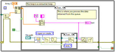

I tried it like this with a kind of state machine.
The "problem" (that I saw, there might be others) is that I need 2 buttons ("stop" to close the producer loop, and "save" to close the consumer loop). And it would make more sense with one. But it seems I cannot stop both loop at once.
And if I don't close both, I cannot come back to the "wait" state.
Never this close to the goal 😉
Message 28 of 29
(2,797 Views)
Hi
The idea was that the consumer part would see the error of the close of the queue.
But the merge errors is holding that.
So you don't need to have a save button but the merge error should be after the release Queue function.
So just swap positions for release Queue and Merge Error and remove your save button and the OR.
