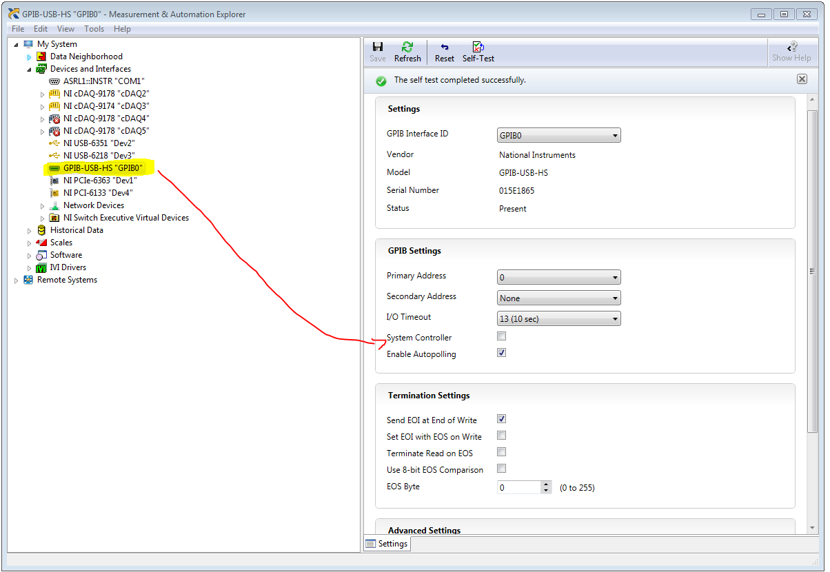

Can the USB-GPIB-HS be put into slave mode (non controller mode)? I know the PCI versions can be but not sure about the USB-GPIB ones.

12-14-2016 10:28 AM
I believe you can. Check this out.
