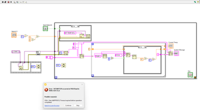

I'm running into an issue when running the attached VI.  Seem to not be able to get this VI to function.  Arduino code was uploaded successfully, but there seems to be a timing issue when running the VI in Labview.  Any help is appreciated.  Thanks.

The error occurs after inputting setpoint while running the VI.

There are a few issues with that code.
I think the error is associated with the fact that you cannot Write and Read in parallell to the Arduino. You have to execute commands to the Arduino in series.
Next, I'm assuming your Send Setpoint is a button.  Its value is never updated in the while loop, so you might set the setpoint once on first execution.  If the control was inside the while loop it would be checked every itteration.
Those time delays are not executing in any beneficial way.   The error needs to run through the sequence with the time delay.
If you attache the VI, and not an image of the block diagram, then someone might edit things to show you a better way to do things.
Craig
(1,200 Views)
Thanks Craig.  VI file is attached on the initial post, directly under the code.
(1,191 Views)
Sorry, missed the attached VI.
I've created a simple state machine from the code in your VI.
Watch how it runs in Highlight Execution mode and then can modify as needed.
Craig
