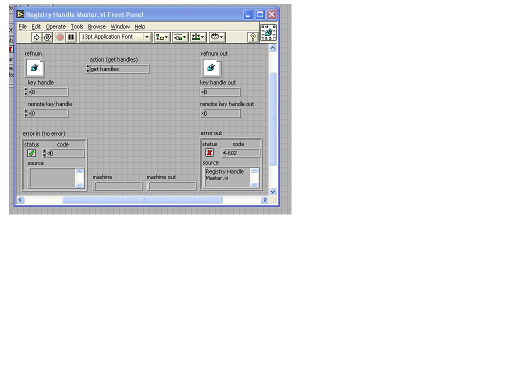

 Thank you, I think the problem is the registry handle master and registry key, but I do not know how to find or correct the code and key...registry handle.JPG

Hi caiusdeng,
Still it might be handy to first give some additional information like the vi's you are using and camera type.
The next step is look in the 'block diagram' where the first problem occurs. 'highlight execution' light bulb.
Be aware that getting the ccd.vi working is the first simple step. The spectrum you will get is just some pixels and intensity.
Afterwards it have to be converted to wavelength. I'm not involved in that project anymore but they still seem to struggle with that.
Message 16 of 36

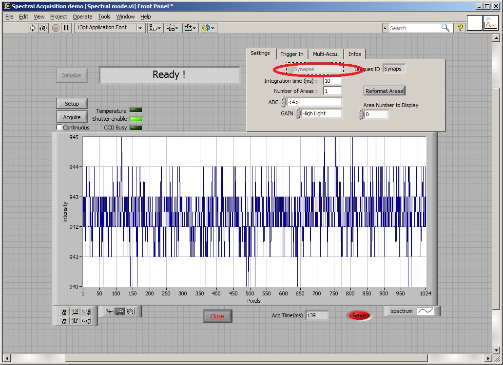

 The spectrometer we are using is the IHR550 and Synapse CCD, the vi is just download from the Horiba Jobin Yvon website, i think the version is  0.9.4, thank you very much for your help.
Message 17 of 36
(7,835 Views)
OK, that's step one.
In the New-Symphony-Synapse LV20101 map there are 2 llb files.
1) The global_lib.llb with the control vi's.
2) The User_lib.llb with some example vi's like: "Image mode.vi" , "Spectral mode.vi" and "version Number.vi"
You will probably notice these vi's are a little bit messy.
Now start the "Spectral mode.vi".
In frame 1:  read detector uniq-id.vi gives registry info of the installed detector.
In frame 3:  Initialize CCD.vi is responsible of activating the CCD.
When checking the block diagram (message one of this discussion) you have to check if and when the vi gives an error.
Let me know.

Dear pjr 1121,
I attached the working key of my registry.
In the key are two detectors; synapse and ccd1.
They both appear to work.
In the example program the CCD is set to Synapse by default. This name should match the registry name. So delete it and just make a string constant instead.
I don't know if in your software package the config.exe is available as well but if so use passwd: admin and use "auto detect ccd". After this the ccd was added in the registry.
