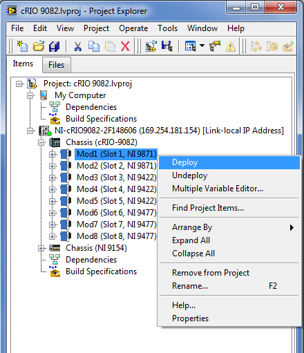

9871 Ports are not Detecting in MAX
1.- First, create a scan mode project, then you have to click "Deploy"
2.- In the MAX, you can see the ports RS485 and  COMs
3.-Next, create a FPGA mode project and  create a "simple serial VI" (you can download it here)

Ing.LARA,
After struggling with this for sometime your instructions worked. When I created an FPGA Interface project as you stated (Step #3) I had to drag my 9870 to the Controller (Hybrid Mode) then select 'Deploy All' from the chassis and everything worked. Thanks for the step-by-step.
Craig
