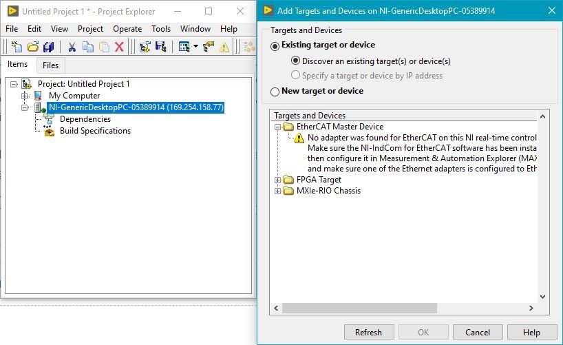

Hello everyone,
Currently I am doing a same project as Smrgol but different hardware, I setup a Beckhoff IPC as Real time targer and I want to use this as my EtherCAT Master. Previously I am using ADlink EU-series as EtherCAT slaves, because of the missing of XML(ESI) file, now I am using Beckhoff I/O device asEtherCAT slaves.
I follow all the instructions in the documentation and other resources, but now I am stuck at the EtherCAT Master detection.
http://www.ni.com/product-documentation/10555/en/
From the website above, I faced the problem at Step 4: Configuring the Network in LabVIEW.

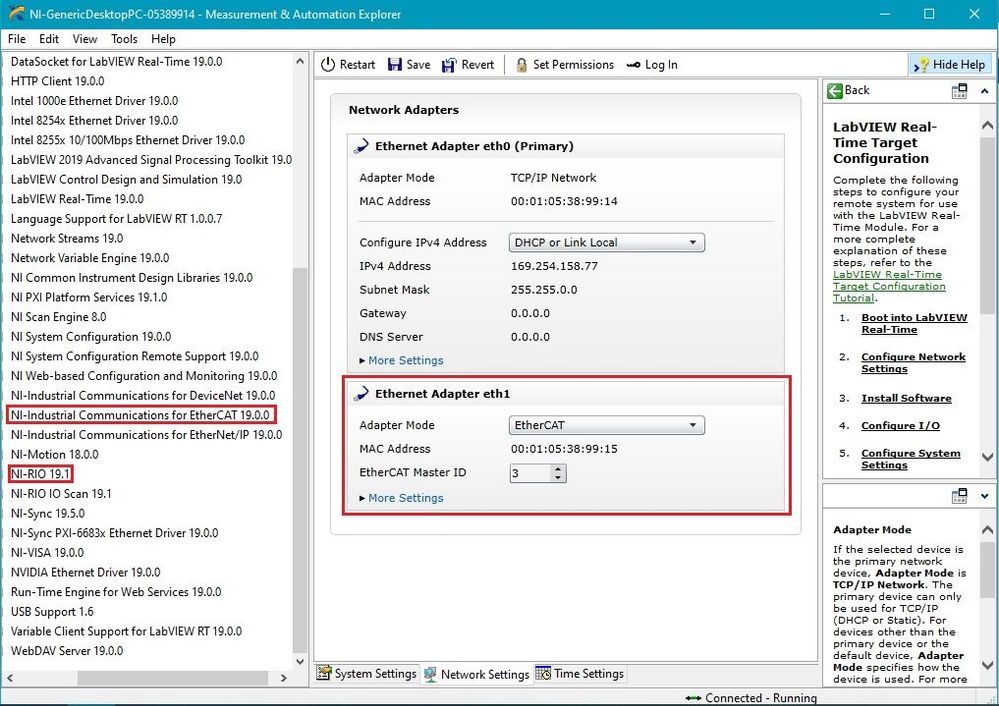

From what I know so far, there are two factor will make this happen:
1. The compatibility of IndCOM for EtherCAT and NI-RIO version, my IndCOM for EtherCAT is 19.0 and NI-RIO is 19.1, which is compatible;
2. Set the one of the Ethernet Adapter's Adapter Mode to EtherCAT.
I also tried restarting my labVIEW, the Beckhoff IPC, changed ethernet port... but the EtherCAT Master was still undetectable in the LabVIEW. Please tell me what should I do you know where I am doing wrong, thank you very much.

Hello
Use compatable Intel lancard. From now on, it was OK only at giga intel lan card. PC1000 It was OK also.
Message 16 of 18
(2,809 Views)
pro/1000GT
Message 17 of 18
(2,796 Views)
Hi  Kirayet.
I have the same problem.
Have you solved yours?
I have successfully set the second ethernet adaptor to EtherCAT in MAX.
What should I do to make LabVIEW recognize it in the project tree?
I use an Intel 82546 Dual Port Gigabit Ethernet Controller.
