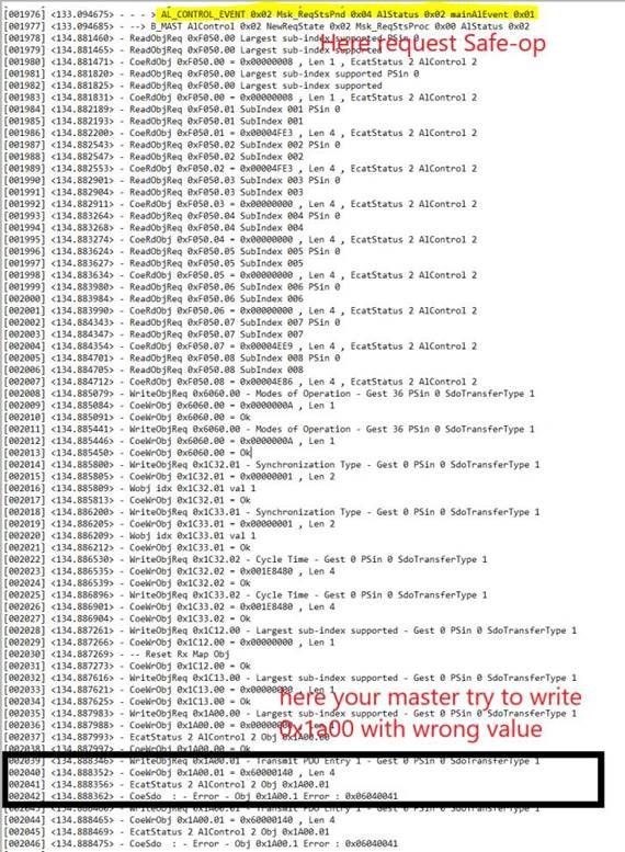

I am testing a Robox EtherCAT S120 drive module with CompactRIO 9047.
The slave can't start to the operation mode. From the logging file, looks the Master is writing the wrong address. The ESI file is attached here.  Hope to get your support soon. Thanks

did you solve the problem? I have the same one.

Hi All,
same issue here.
Every advice It will be usefull.
