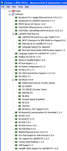

Dirk,
I have the DNET card (PXI-8532) inserted at slot 3 and it is detected under "Devices and Interfaces". But under chassis, slot 3 is not identified. It says "<Unknown/Empty>" for slot 3. Please refer the image below.
Here is the list of softwares installed in PXI. Do I need to install anyother software to detect the DNET card approriately in MAX?
MAX version 5.1.0f0, LabVIEW 2009, Windows XP
Raja

Accepted by RajGru
I try to answer both questions you have:
1. The new APUI is compatible with the old one but if you use VIs with the old APi you have to replace the VIs with the new ones. There is a whitepaper linked to the download page and here it is again that describes how to do so.
2. The devicenet driver does not support the plugin for the PXI chassis view yet. It only shows up under devices and Interfaces and the name is not changable either. Right now the driver uses the numbers in order of detection if multiple boards are present.
Both things will be addressed in our next release by the end of this year.
