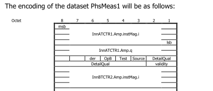

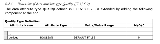

Thank you for your response. Can you please point me to the relevant section of the standard where it specifies that the highest 13 bits are used? I couldn't find anything explicitly mentioning it in 61850-9-2 or 61850-7-3. I had to look at 61850-9-2 LE (available from the IEC61850 user group), to find this information.
R2.1 section 6.2.3 extends the 61850-7-3 quality field with a "derived" bit, and figure 5 shows the quality bits occupying the lower 13 bits of the quality field.
Attempting to publish "0x1FFF" with the example "Publisher.vi" results in a value of "0x1FF8" being actually published.

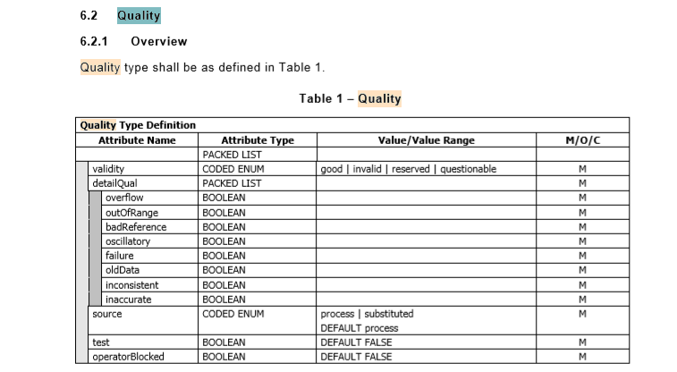

You can get detailed information from NI-Industrial Communications for IEC-61850 Help document. And I also find the related information from the spec of iec 61850-7-3.
Message 7 of 10
(8,583 Views)
Hi zhengchen,
Thank you for your reply. The table you mention in 61850-7-3 does not make any mention of how the various quality flags should actually be encoded into the quality word. 61850-9-2LE specifies a "derived bit" and how the quality field should be encoded.
Is there a way I can support this aspect of 61850-9-2LE with the NI SMV VIs?

Hi nkraemer,
I am afraid that NI SMV didn't support the derived bits defined in the 61850-9-2EL. Because NI 61850 is developed based on the third-party's stack. I also checked the reference materials for developing the NI IEC 61850 software. However, these references don't contain the 61850-9-2EL.
Thanks!
