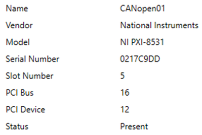

My problem is that I get an error when trying to create the interface. I can see the card in MAX and it is named "CANopen01". However, when I use CANopen Interface Create.vi to create the interface, I get error −2147136892: The CANopen hardware cannot be found. Ensure the CANopen hardware is correctly installed. Ensure you use the correct port name. You can get your device port name(s) in MAX.

So I am pretty sure that the intent is for the cards to be numbered from 01, since this the documentation states:
interface name specifies the name of an interface that you want to create. The name of an interface must be CANopenXX, where XX is the interface number. The maximum interface number is 32.
The screenshot from MAX shows the card name clearly:

I think I have now solved the problem. What was not obvious to me from the documentation is that the input parameters are strict typedefs, rather than numerical values. This is different from the old way of doing it, which threw me off, since I have been updating existing code with seemingly like-for-like replacement VIs.
Here's what works:
It grabs the card name automatically (if you only have one card), and you can set the baud rate from the front panel.
