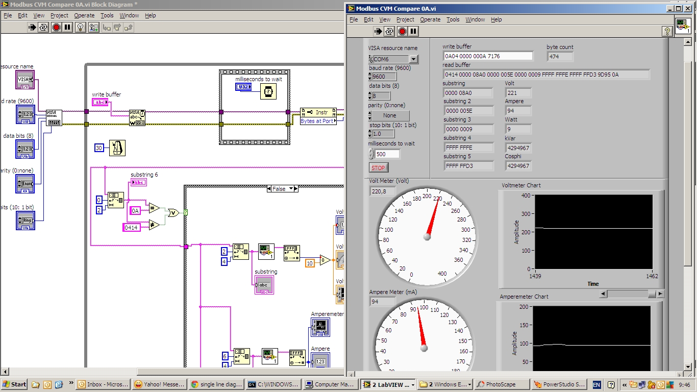

i have problem about communication serial on RS-485 using NI VISA.
my problem is sometimes the data that must be read from power analyzer suddenly loss, can i skip that problem ? so if the data loss my program do not parsing-data from power analyzer, and then sometimes suddenly data is to high ( i think error on read VISA ) can i ignore it to ?
i did many program and still not work correctly

Do you use ModBus ASCII or RTU. Please post the VI for check and not a screenshot.

this is my update, i compare on byte count, so if byte count is 49 then the program pharsing data, if else do nothing. but in this program sometimes byte count increase continously. i dont know why the byte count increase continously.

You are using ModBus RTU. You should disable the termination character.

is one of the inputs at 'Configure Serial port' VI. This is default true. You set it to false.

i've tried it and still not working. its made byte count stuck on 25. this is my screenshot
and then i record video for you, i tried something, change the delay and it success made the count byte decreased, but it will increase again. please watch this

With the command you send the maximum number of bytes you will receive is 25. So I think it works just fine.
You send: 0A 04 00 00 00 0A 7176
 That is: slave 10 (0x0A), read register (0x04), starting at address 0 (0x00 0x00), read 10 registers (0x00 0x0A) + CRC (0x7176)
That answer is: 0A 04 14 xxxx CRC
 That is: 10 (0x0A), read register (0x04), number of transmitted bytes 20 (0x14), data 10 registers = 20 bytes + CRC
This adds up to 25 bytes.

i change method to compare the first string must be read. this is my screenshot and can work perfect
