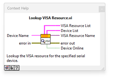

Hi Jeff,
The LabVIEW VISA library can be used to access serial devices on the Raspberry Pi. It works with the standard LINX installation on the Raspberry Pi. The library works on the Bookworm and new Trixie versions of PI OS.
The VISA resource name used by the VISA VI's is in the format ASRL1::INSTR. I have attached a VI that I wrote to lookup the VISA resource for a specified Linux serial device. Hope it is of use for your application!
The Lookup VISA Resource VI can be run standalone on the Raspberry Pi and displays a list of the online serial devices.
The example below shows the output from a Raspberry PI 4 with the onboard serial interface, USB RS232 serial adapter and a Raspberry Pi Pico connected.
The outputs from the VI are the VISA resource name and a boolean that is true if the device is online.
There are also array outputs of the VISA resource and device lists.

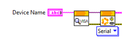

Here are examples using the VI with VISA and the LINX serial open VI's
 VISA
 LINX (For LINX I/O device e.g. Arduino Uno or Raspberry PI Pico)
