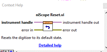

I have some more info to add.
When we add the NI-scope Reset vi as the second vi after the NI Scope Initialize, the problem gets much worse.  We get a bad channel every time we test our application.
Then we tried less resetting by changing the default RESET=True behavior of the NI SCOPE Initialize VI to false.  Doing this, after system reboot, we always get one channel that is dead.
