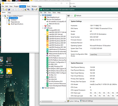

and am to the point of creating a project, but my installation doesn't include the FRC RoboRIO template.  I've crawled through the package manager, and I have FRC game tools and CompactRIO installed.  The RoboRIO does show up in MAX, but I'm not seeing any RoboRIO-specific I/O blocks when I go to add things in the block diagram.  I've tried both LabVIEW 2020 and 2022.
I've also tried to manually add the device in a blank project, but nothing is showing up when I try to right click to add a new device in the project.  Here's a screenshot showing what I have installed and you can see the RIO in the devices list.
Appreciate nudges in the right direction, or a pointer to a more up-to-date tutorial.  Thanks!

Sounds similar to the problem reported here: ChiefDelphi: Install/activate
This happens if the FRC Game Tools are installed before LabVIEW.
I recommend to uninstall and reinstall the FRC Game Tools.

Thanks for your reply.  It turned out I had a number of missing dependencies - One Windows, and a couple NI.  Got everything installed in the right order, running the right version of LabView and I now have a blinky LED on our RoboRIO!
