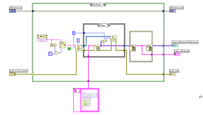

I seem to have reference leaks in some of my DVR GOOP classes. I don't believe these classes are singleton like described in this thread, because I can set class attributes. I found the reference leaks with the Desktop Execution Trace Toolkit (DETT). My application crashes on a production server upon closing the application, even though it never crashes on any of my devand test machines. The reference leak errors appear in DETT when I close the executable.
One in particular that is part of GOOP is classname.GetClassAttributes.vi. This is one of the utility VIs that uses a queue that isn't de-allocated when an object is terminated. How can I deallocate this class reference? Isn't it supposed to be de-allocated automatically when all objects are terminated?

The utility VI GetClassAttributes.vi has this block diagram:

You are right, that design pattern "ClassAttribute" don't give you a way of destroying that Named Queue.
But you could always wire the name out of the queue to an indicator so you can force destroy it like the above example.
I have updated this VI in the latest version of the tool (I'm currently running 1.2.85, you'll find it under beta testing).
That version looks like this:
But since this VI is not re-entrant (and if we keep it that way, we could just change the code to this:
But still you have to make the decision of when it's okay to release this ClassAttribute DVR reference.
Something like this:
