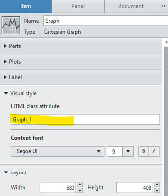

I'm building a graph which consists in having amplitude in Y while Timestamp on X
I'm using a cluster which reciever data from 2 arrays(amplitude  history and timestamp history)
However, when hovering in the graph, the timestamp value converts to a non timestamp value as you can see in the image below.
I wonder if i can see the timestamp hovering the data point..Therefore, i know the exact time the value was aquired.

Hi, i found the library PlotHoverTooltip, and i'm trying to use it, however i've come across an error.
Since my code is a little different, and the graph is displayed by a cluster i dont know if it impacts on the error.
The example attached with the library worked fine, but when i use it in my project i get the follow error:
JavaScriptInvoke in Library::Support::PlotHoverFormat.jsli::Plot Hover Format X AbsTime->Library::XAbsTime GraphTooltip.gvi->WebApp::Páginas::Function.gviweb<APPEND>
An exception occurred within the external JavaScript function called by a JavaScript Library Interface node. Verify your JavaScript code is valid.
function: PlotHoverFormat.XAbsTime, Additional information:
Message: Cannot read property 'querySelector' of undefined
Stack: TypeError: Cannot read property 'querySelector' of undefined
at Object.XAbsTime (http://localhost:54907/HtmlVI/Run/VireoDevSystem/Interactive/Library/Support/script.js:9:74)
Have you define your Graph Control HTML Class Attribute?
And you need to make sure that your Graph has a plot on it. that for, wire the error cluster.
And you don't need to double write to your graph value.
(3,123 Views)
It worked, thank you!
