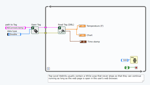

I reinstalled all the recommended G Web packages, and opened the NI Server LabView project, which already has the HTTP Selector configured for localhost.  I opened the W Web project, and per the video, I removed the SystemLink tag portion and added a SystemLink/Open Configuration with the URL set to http://localhost, the user "admin" and the password "test" (I verified the password is test in the NI Web Server configuration).   I also built a package and imported it into the NI Web Server.  It runs the same in both the G Web GUI and a browser; see the attached sample output.  I'm getting "NaN" for the temperature.  I verified the output values are both doubles in the LabView and G Web App.  I also included a screen shot of the LabView and the G Web block diagrams.  Is there an obvious reason for this?  It's almost working.  Thank you for your response.

Hey johnsmith2022, I don't see anything obviously wrong. Some ideas to help debug the behavior:
  • To verify that the LabVIEW application is writing to the tag correctly, you can inspect the value in the Tags Viewer by visiting the server, clicking the navigation menu, and choosing tags, ie if the server is at localhost then http://localhost/#tagviewer
  • WebVIs do not show error dialogs when there are unhandled errors on the wire. If there are unhandled errors you can see them in logs in the editor by going to View >> Output or in the browser by opening the browser developer tools and looking at console logs. Each browser has a way to view console logs and in Chrome you can use ctrl+shift+j to jump directly to the console log.
    Additionally, make sure to wire-up error handling so that you can see log output if there are any messages. The current screenshot (and unfortunately the example as currently posted) does not do expected error handling of stopping the loop for errors and presenting it to the user via indicator / show dialog / etc.
  • When running WebVIs in the G Web editor, make sure the G Web editor is set-up to use the NI Web Server. Can verify using File >> Preferences >> Web Server and verifying the NI Web Server option is selected and the Web Server is configured and running.

Hi johnsmith2022,
The log you posted makes it seem like you are running a deployed WebVI (deployed by building the package and uploading it to the web application hosting service). In the deployment scenario you need to double check that you remove credentials / open configuration from the diagram altogether:
Alternatively, you may want to first test in the editor (which I would not expect the policy evaluator logs) by using the Run command or the Run >> Run in Browser command. The video starting at 17:40 describes how to run in browser and also describes configuring the NI Web Server when using the Run in browser command. When using the Run or Run in Browser commands you need to include credentials with the open configuration VI (note that the url is not actually needed when using Run or Run in browser assuming that G Web is configured correctly with bullet three from above):
The above assumes you have validated from the previous post that bullet one (the tags are publishing correctly), bullet three (g web is configured to use the NI Web Server), and bullet four (the services are all running).
