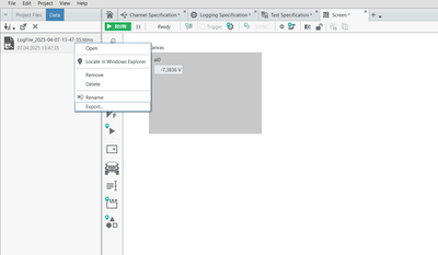

Hi, I am new to Flexlogger. I am running some test and I would like to copy and paste the numerical value on my dashboard. Any idea?
Please refer to the picture attached.

I am not aware there is the option to copy the numerical values from your dashboard. However, you can convert your data logs (tdms files) to a .csv file. The csv file can then be opened in Excel (By default, csv files are opened in Excel on Windows).
