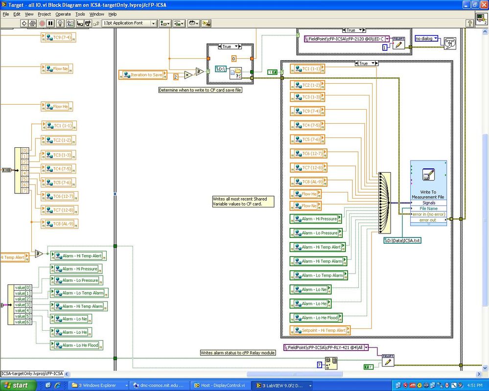

I'm not sure whatwould be helpful to tell, but I'll try. Screens attached at bottom.
Basically I am reading Analog IN from two modules, Digital In from one module, and writing to a Digital Relay module. I write everything to, and generally read everything from, the shared variable nodes. At some defined interval I write the shared variables to the flash card on the cFP (here I've inserted a "False" constant so it never writes since when variable "Iteration to Save" goes to zero it goes to town writing). All errors are suppressed and passed out to be read by the PC.
There's not much processing as you can see in the screenshots. Originally I had a timed loop running at 500ms, but here I've changed it to a while loop executing every 500ms (thought it might help, it didn't). I've also set the cFP bank pause time to 10ms in the project properties so it is generally very low CPU and memory usage (about 25% each according to the DSM).

Your code looks pretty good.  Nice layout!  I would suggest connecting the error terminals for your Shared Variables since this will allow LabVIEW to better determine execution order.  This will allow for your code to execute more efficiently.  Alliteratively you could use the Shared Variable API instead of the Shared Variable Node, but this probably would be more work.
The file I/O operation is also probably pretty expensive; especially since you are using the express VI.   It will probably be more efficient if you open the file in the beginning of your program and write to it continuously until the program shuts down.  This may not be a trivial change depending on you application, and I would hold off making this change until we can determine if CPU usage is the cause of this behavior.  I suggest using the diagram disable structure to "comment out" parts of your code (such as the Write to Measurement File VI) to see if we can avoid the issue.

I had thought about the expense of the file VI, but eliminating it didn't help. I also wired up the error terminals; good to know that can improve performance.
I ended up solving my problem by re-installing the OS (XP) and then doing a fresh install of LV 2009f2. I'm using the same program on the cFP and PC, and the shared variables no longer drop out.
