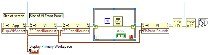

This example expands the Front Panel size to fit full screen except the task bar
Description
This VI will take the desktop space available and fill it with the front panel. Once the stop button is pressed, the VI takes the initial values for the front panel, before it is ran, and returns it to the original size.
Requirements
LabVIEW Base Development System 2012 or compatible
Run the VI, the Front Panel will fill the full screen area
Press the Stop button to restore the window size to its initial size and location before running the VI
VI Block Diagram

Without you I'd never find that App Property Node.
Special Thanks.
